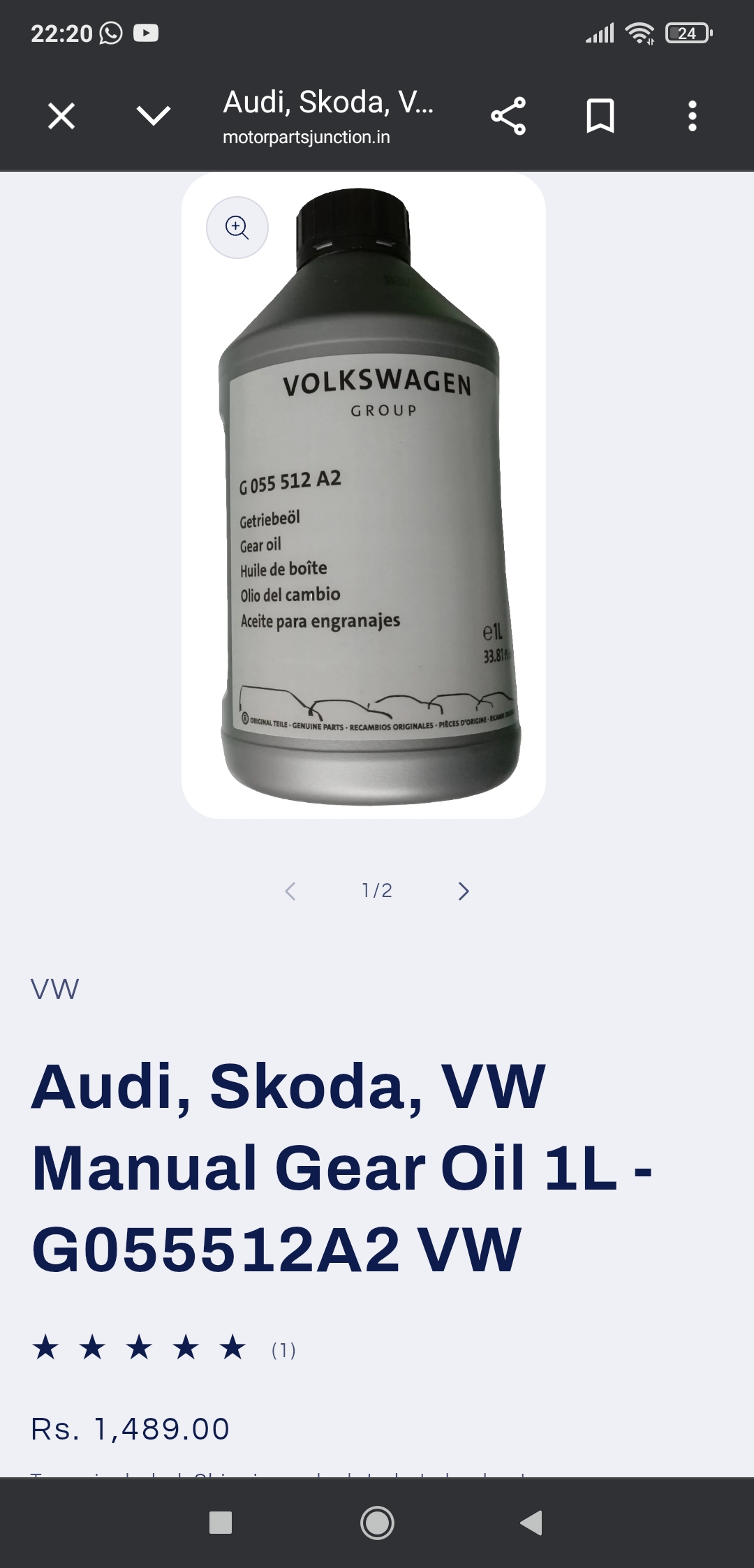

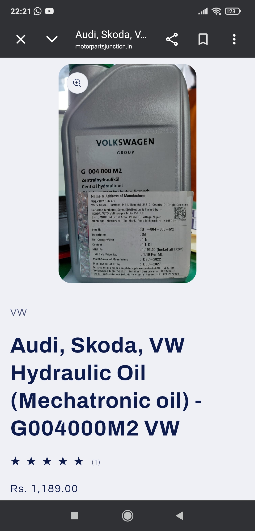

Bro dsg oil hydrollick costs just 3200 and and gear oil costs 3000 in total 6200 in parts . Get it done outside it's very overpriced . You can get it done outside for just 10k .. you need 2 liters of gear oil , 1.2 liters mechatronics oil
